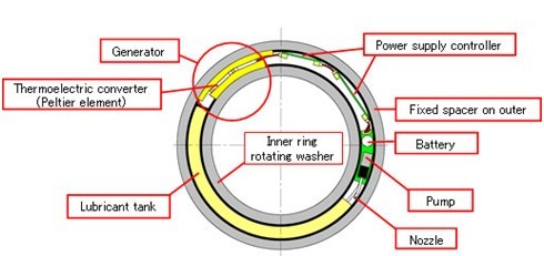

The “Lubricating Oil Supply Unit with Self-power Generator” features a generator, battery, controller, lubrication tank and oil delivery pump built in to the spacer of the outer ring adjacent to the bearing. Electrical power is generated from the temperature difference between the inner and outer rings of the bearing when the bearing is rotating, which drives a pump to supply micro amounts of lubricant to the inside of the bearing. The amount and interval of lubricant supplied is controlled via a program, which ensures reliable lubrication over a long period of time. This unit does not require any additional piping or wiring, and can be assembled on to spindles of machine tools in the same way as conventional bearings.

(1) Built-in self-generated power supply and lubricant tank, eliminating the need to supply external electrical power or lubricant
(2) Same bearing and spacer assembly process as conventional products
(3) The amount and interval of lubricant supplied can be controlled via a program for long-term reliability

[ Structure ]
