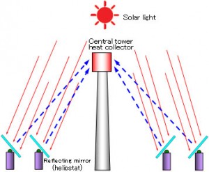

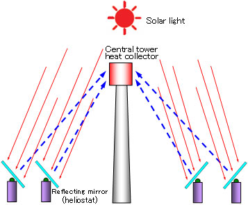

Tower type solar heat power generation plants designed to use the sun’s energy effectively utilize a reflecting mirror to track the movement of the sun, with heat from the solar light collected at the central tower used to generate power. Devices used to track the sun are generally designed so that the angle of elevation moves linearly, with rotation and drive moving around the horizontal angle.

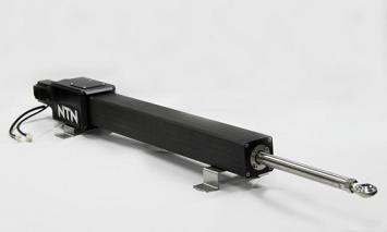

The “Motorized Linear Module for Tracking System of Solar Heat / Solar Light Power Generation” developed by NTN uses a linear module type cylinder powered by an electric motor drive system. The use of a ball screw for the feed screw gives the module a high repeatability of the position and durability for extended use. Grooves have been machined into the track surface on the inner surface of the body that forms the part of straight guide, and a rolling bearing as the guide roller to ensure smooth linear guidance and a high rigidity.

[ Product photo ]
Motorized Linear Module for Tracking System of Solar Heat Power Generation
e.g.) Body: length 935 mm, 75 mm square, stroke length: 500 mm

Image of tower type solar heat power generation plant
Heliostat mirror for reflecting solar light
