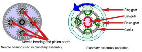

*Planetary assembly: A gear shifting mechanism used in ATs that adjusts output speed and torque by utilizing a combination of rotation and revolution movements of multiple gears.

NSK, however, has developed a way to optimize the heat treatment process, making it possible to use existing production equipment and still increase the durability and dent resistance of the roller.
Product features
Smaller, lighter AT
This needle bearing achieves 50% more durability life and 15% more dent resistance compared to conventional bearings, which makes it possible to make it smaller and lighter.
If a thinner bearing is the higher priority, then a 12% downsizing is possible.
If a lighter bearing is the higher priority, then a 25% weight reduction is possible.
