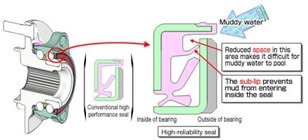

In response to this situation, NSK has developed a hub unit bearing with a high-reliability seal that achieves superior dependability in the most challenging conditions by suppressing the increase of friction and improving muddy water resistance while utilizing the same-sized seal as its conventional product.
Product features
1. High reliability under severe conditions
The addition of a sub-lip to the seal prevents mud intrusion, which can hinder the movement of the lips.
This feature improves muddy water resistance by 1.5 times compared to the conventional product.
2. Compact seal
By keeping the size of the seal the same as that of NSK’s conventional high performance seal, the company was able to keep the hub unit bearing size the same as well, thereby enabling use of its new high-reliability seal.
3. Friction increase avoided
Through the use of computer analysis, NSK optimized the surface pressure distribution on the seal lip so that, even with the addition of the sub-lip, overall sliding resistance in the seal was still reduced.In this way, NSK has been able to achieve the same friction level as its conventional hub unit bearing.
