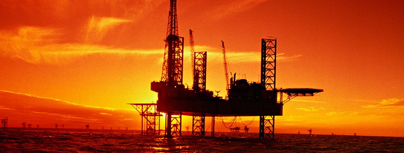

The hundreds of offshore drilling platforms operating along the world’s continental shelves are some of the most expensive structures on the planet – in addition to being some of the most remote and vulnerable. The main danger to drilling operations out at sea is large waves created by hurricanes and other storms.
That’s why the jack-up oil rig is the most popular type of movable drilling platform, used in relatively shallow waters up to 120 metres deep. The threat of waves can be neutralized by jacking up the platform above the sea surface on three or four legs that rest on the ocean floor. Typically, each leg is equipped with three rack-and-pinion systems, and each rack-and-pinion system has six powerful gearboxes.

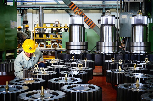

Gear setting for key machining at the Hyosung plant.

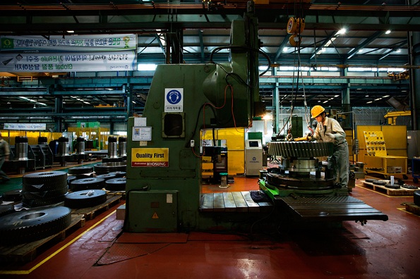

Sang-Kyu Kim during gear shaft machining.
