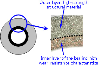

The newly developed “Multi Layer BEARPHITE” is an oil-impregnated sintered bearing that features the internal layers of the bearing made of a material with a high-strength and outstanding wear-resistance, and the outer layers made of a high-strength structural material, in what is the world’s first double-molding method*1. The use of high-strength structural material for the outer layers of the bearing eliminate the need for special heat treatment, and greater dimensional precision with the sizing*2 process using a press means conventional cutting process is no longer required.

[ Features ]
The double-molding method, which is used to cast two dissimilar materials into a single object, has been used for high-strength and outstanding wear-resistance
(1) Radial crushing strength of 500MPa or more, oil content of 17 vol% or more
? Optimized material and sintering conditions for the required strength and oil content without any special heat treatment
(2) Variation in inner and outer diameter dimensional precision of 50 ?m or less
? Sizing process used to maintain precision, eliminating the need for the cutting process
(values for (1) and (2) above obtained from test results of a bearing with dimensions?35×?45×35)
