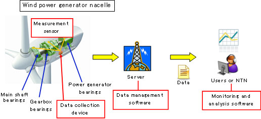

The “CMS” developed by NTN features a data collection device, measurement sensor, and data control, monitoring and analysis software. The world’s smallest class data collection device has been used, which allows installation in nacelles easy, and can be adapted to suit existing wind power generators. With outstanding levels of water and dust-proofing, the device is designed for a variety of different environments, including offshore locations. The device also features automatic diagnosis of highly accurate measurement data, and combined with various different software packages for condition monitoring, the system allows the condition of bearings, gears and other components to be monitored in real-time from remote locations. This system ensures that defects in each component can be identified faster to help prevent spreading damage throughout the nacelle. It also allows preparations to be made for replacement components in advance, and repairs to be conducted systematically, which not only reduces maintenance costs, but also limits reductions in the operating ratio of wind power generators. The “CMS” developed by NTN was the first in Japan to acquire GL*4 certification, a certification system developed for wind power generators.

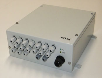

| (1) | World’s smallest class data collection device (250×290×108mm) | |
| ? | Compact and space-efficient, allowing easy installation in existing nacelles | |
| (2) | Suited to offshore installations and a wide range of other environments (usage temperature conditions: -20 to 60°C) | |
| ? | Outstanding levels of water and dust-proofing | |
| (3) | Highly reliable diagnosis information | |
| ? | Automatic diagnosis function using highly accurate measurements, as well as allowing real-time monitoring and data analysis | |
Data collection device
Product dimensions: 250 (W) × 290 (D) × 108 (H) mm
Product weight: 5.0kg
