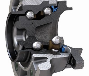

The SKF Low Weight HBU is a flanged hub bearing unit that, by combining steel with aluminium, weighs up to 30% less than a standard HBU, and thus contributes to significant weight reduction in automotive wheel ends.
In premium cars, weight can be reduced by 1kg per axle and in light commercial vehicles, each axle can be lightened by 3.5kg. These reductions in weight improve fuel economy, which ultimately results in the lowered CO2 emission.
